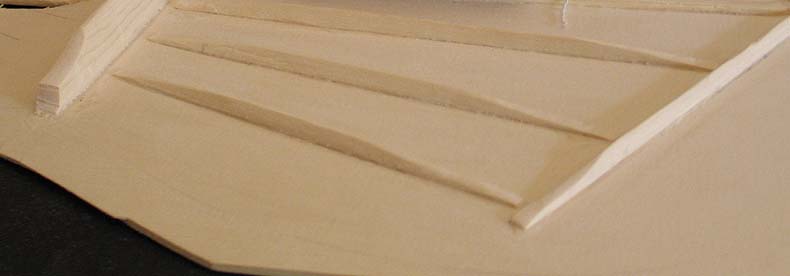

PostPosted: Sat Mar 31, 2007 11:01 pm
Location: Bucharest, Romania
Country: Romania
Bracing done, save for the soundhole patching.  I still got to do some
dressing on the fans.  I really like my harmonic bars, they ended up
very neat and clean which is great considering all i used was a swiss
army knife and sandpaper
The center fan is flat simply because i started using my flat braces
(top leftovers) then changed my mind, posted this thread etc.  From
center to waist, they were 7x7mm, 6x6 and 5x5 profiles (or about that)
then swissknifed to triangles then tapered.
The top thickness is pretty much as it was in the center, and down to
2.5mm at the waist. I planed the graduating to the end, after i string
her up and hear how she sounds.
Build log
PostPosted: Sun Apr 01, 2007 12:21 am
Posts: 2186
Location: Newark, DE
First name: Jim
Last Name: Kirby
Alex - Hi and welcome. I'm pretty new to classical guitars myself, so take anything I say with a grain of salt (or two, or three).
If you are at 2.8mm under the bridge, and down to 2.2-2.5 around rim, I'd guess that your top is way overbraced. The fans and particularly the lower closing braces look too tall. (Are Hausers that way too? I know he used a thick top, but he must have compensated for it somewhere.)
Just an opinion. I'd still be shaving. Do you know about where the main top resonance's tone is?

PostPosted: Sun Apr 01, 2007 4:13 am
Posts: 993
I've built only Hauser style classicals and my first thought was that your braces look much too tall. Braces follow the cubed root rule, for example, If you have a brace 2 mm high and another 4mm tall, the 4mm brace will have 8 times the capacity for supporting the load (2x2x2). If you made it 6mm high, it would have 27 times the capacity to support. So in other words, your top gets extremely stiff as the braces go up just a little. If it's too stiff as your appears to be, there won't be enough energy from classical guitar strings to get the top moving, and you will have a very dead sounding guitar. Also, that center brace that seems wider and flatter, for the same amount of weight, you could have a taller and skinnier brace which would add more stiffness without additional weight. That's the whole key here, you want it as stiff as possible, but also as light as possible without compromising the structure. It's a balancing act. It took me a few guitars to even get it close.
Good luck!

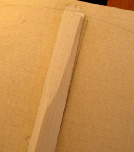

PostPosted: Sun Apr 01, 2007 5:44 pm
Posts: 1051
Alex, it is looking good. I think that while your fan braces are tall, it should be okay as long as you get the resonant frequency you are going for.
One small suggestion and that is that because you want the top to vibrate as freely as possible, you may want to taper the ends of the fan and angled end braces down to about .5 mm as most of the strength will come from the height in the middle of the brace but if the ends are tapered down the top will be more frre to vibrate in those areas.
Because is difficult to see the width of the center cross brace but it looks a bit wide. With the cross brace you want to balance the stability needed but to not choke off the sound so you can thin the sides of that brace while keeping the height and it could help.
Good luck, the journey is as much fun as the destination when building guitars.
PostPosted: Sun Apr 01, 2007 7:22 pm
Country: Romania
I need to confess the purpose of a wider central fan brace. Before attaching any braces I started to sand the top to get some initial graduation. Between sessions I was measuring the thickness and flexing along grain to see how it changed. It seems I flexed too much, and i got a hairline snap along the central seam, at about 3mm distance, about 3cm long. It is entirely covered by the endblock, V brace and central brace, but just to make sure I glued a wider central brace (8mm)
The middle harmonic bar is 9mm wide and 20mm tall.
Since it is day time I can pump more volume and get a better feeling on resonances. I picked up a new one at 77 Hz, noticeable stronger than the 220 Hz one if I hold the plate by the upper bar or lower waist. 220 Hz is still the stronger one when holding by the middle bar or the areas between fan braces.

PostPosted: Mon Apr 02, 2007 7:27 am
Posts: 2485
Location: Argyle New York
Last Name: Collins
City: Argyle
State: New York
Zip/Postal Code: 12809
Alex;
Ihave repaired many great classicals and the tallest fan for a "Spanish" sounding should be no taller than 6mm -BUT you have to listen & flex the top to get an idea of what you need.
I personally use 5mm & 4mm wide braces depending on what top wood I'm using.
I've used fans from 7mm tall down to 3mm .
It really all depends on the tone(sound) you after.
Light braces give more warmth-stiff ones help the treble and in many cases the bass.
You have to be careful with body volume(Depth)
And width.
A deep body makes for more bass.
Which most nylon strings do not need unless they are over-built.
Your top thickness graduations look great !

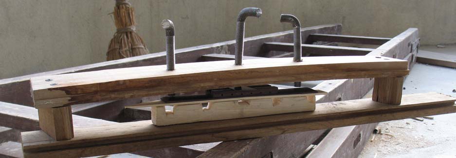

PostPosted: Wed Apr 04, 2007 2:34 am
Country: Romania
Because I couldn't find any good size C-clamps at the hardware stores yet and I don't have any patience left and for other reasons i decided to glue the bridge before gluing the top
So, folks, meet Clampzilla    It's made from old oak tiles, and the top one was already bent by drying near the fireplace. All together it's rock solid and can put a good amount of pressure. I've tested and there are no gaps left when tight.
I'll be using LMI white (yes HHG on my next project)  I guess I'll put a liberal amount and let the clamping squeeze the excess out.  But I might overclamp? Perhaps i could count the numbers of turns needed to remove any gaps and use that when there's glue in between ?
Build log
PostPosted: Wed Apr 04, 2007 2:43 am
Posts: 323
Hmmm..... Maybe I'm missing something here, but aren't you supposed to glue the bridge to the top?
PostPosted: Wed Apr 04, 2007 2:56 am
Country: Romania
Yes, the pic shows a test. Instead of the actual top I use a 3mm spruce stripe to check for gaps.
Build log
PostPosted: Wed Apr 04, 2007 3:59 am
Posts: 2711
Location: Victoria, BC
Last Name: Abercrombie
I'm not sure I understand.
Your plan is to glue the bridge to the top before you attach the top to the sides/rims?
This could work, but you will have to be extremely accurate in all your positioning during further assembly.
The advantage of doing the bridge last is that you can compensate for small errors to get a guitar that will play in tune.
You could use your bridge clamping device on the assembled guitar if you supported the caul very well inside the instrument (with props or small screw-jacks) and used light clamping force-it shouldn't take much force if the bridge is properly fitted anyway. If you got too enthusiastic, you could crush the top, of course.
